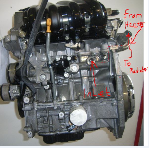

  2. Hi travor Thank you for your prompt response. I ve been thinking I could put a T pipe and join on the one returning from the heater as it seems to share the same path with where it would have been connected on the original engine. I wonder if this would work? The attached image shows what the original engine was like. On the one I have now that inlet part is blocked. From what you are saying, will it be okay to use the inlet from the heater? I have the old block and cylinder head and after tracing the path, I noticed they kind of link on the inside.
  3. Good day guys. I recently got a low mileage HR16DE motor for my Nissan Qashqai 2008 model, 1.6l. I figured I could mount the engine under the hood by myself though am not a machanic, it looked straight forward, and I won. Everything went well, connected all terminals, car starts and the engine runs smooth except one thing. The motor I got came off a Nissan Tiida (also uses HR16DE). Originally my qashqai has a closed cooling system, no radiator cap, I pour coolant through the reservoir and it goes directly into the engine. Now, on this new motor, there is no inlet and there is just no way direct the coolant from the reservoir into the system. Just that one part is giving me a headache. Been thinking of bridging one of the pipes with a T shaped pipe but, I don’t wanna do something that will cause my engine to overheat. Kindly assist please, is there a way around this, how do I do it.
