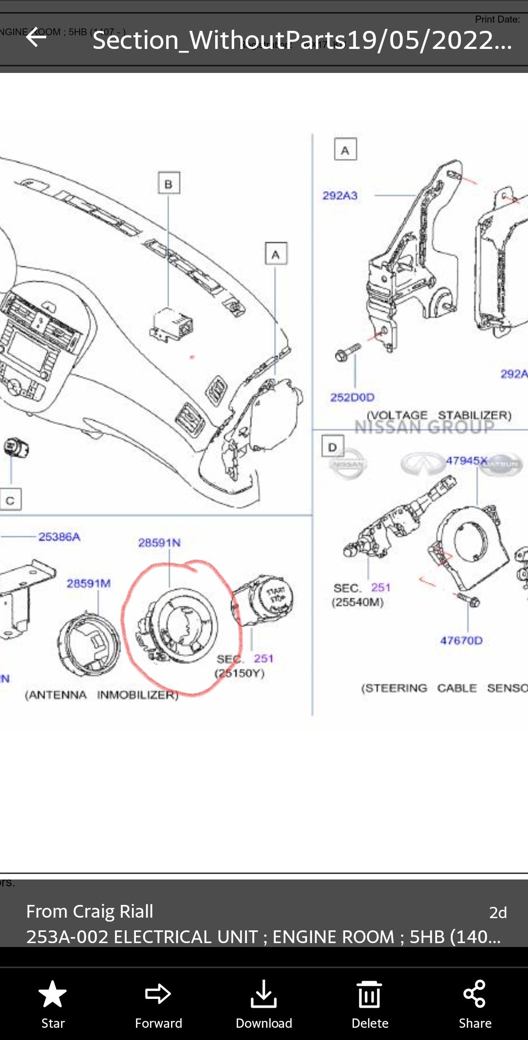

  2. Luke563 joined the community
  3. So when I went to press my start button the other day the button itself fell straight into the centre console it turns out that the previous owner must have been heavy handed with it as all the clips that hold it to the outer ring have snapped allowing the button to fall through everytime it's pressed anyway the outer ring as an electrical connection at the back and I believe its the NATS ANTENNA AMP does anyone know if I can replace the outer ring without it being coded to the car as its only an antenna its the part I've circled in red any help would be much appreciated
