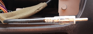

Why does the antenna cable carry a current in this car? The aerial is not a motorised one and is a static fixture on top of the car.

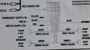

The wires that I have taken out of the ISO wiring harness. The Yellow wire is a constant 12V+ supply, the Blue is labelled Power Antenna, the black is ground (12v-), Orange is Illumination (not needed in this instance) and the red is labelled Ignition/Switched (12V+)
Picture of the Antenna cable for informational purposes
The apparent wiring instructions for the amplifier
