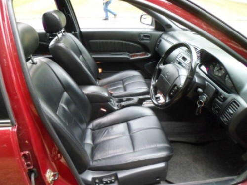

  7. Hi Trevor Not sure why but can only a attach a file no larger than 47.89kB. Had no problem posting the other ones. This is very restrictive as a 640 x 480 pic which are totally acceptable when attached to an email is 73kB. Have attached one of the front interior of the car which I have greatly reduced. Perhaps an administrator can explain the restriction. Mike
